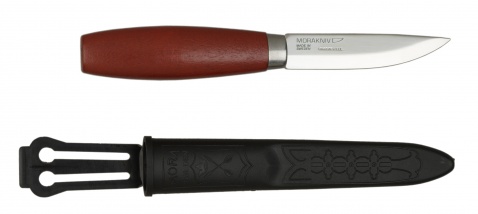

Mora #2/0
Specifications:
Longueur totale du couteau 170 mm
longueur de la lame: 77 mm
epaisseur de la lame : 2.4 mm
largeur de la lame 16 mm
acier de la lame: 1095 carbon steel
dureté de la lame: HRC 59
Type de soie: Rattail tang
emouture: Scandinave, simple biseau
manche: bois
etui: plastique
prix: 9 euro

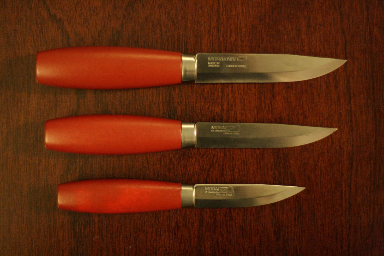

c'est le plus petit sur les photos ... (de haut en bas mora #2, mora #1, mora #2/0) :

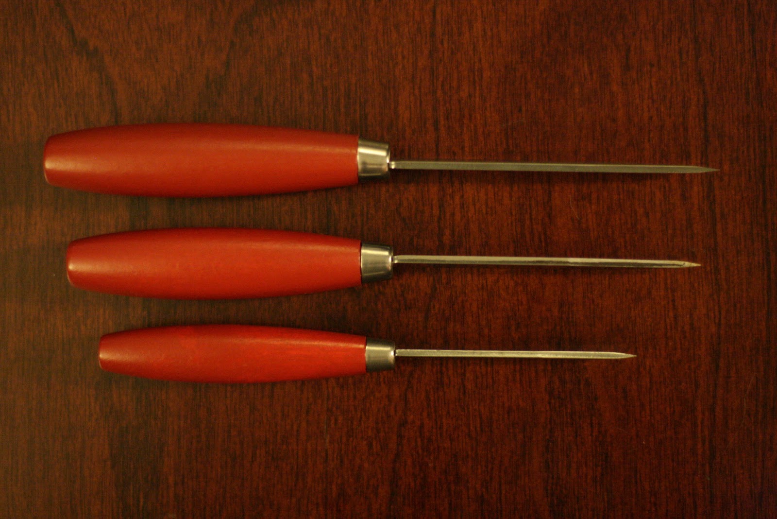

j'aime beaucoup la forme et la finesse du manche:

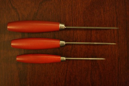

le fameux montage de la soie :
The Mora #2/0 has an additional difference, in that it uses the old blade attachment method for the wood handle Mora knives. It has a rattail tang, which goes all the way to the back of the handle, where it is held with a friction fitting. The Mora #1 and Mora #2 used to have the same attachment method, but in the newer models they have switched to an epoxied partial tang.
